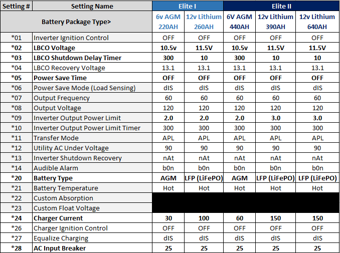

XANTREX INVERTER/CHARGER SETTINGS
Settings changed for 2023 YM & Newer due to the addition of the busbar system. Some voltage is lost between the battery & the inverter.
DO NOT USE THE BELOW SETTINGS IF YOU DO NOT HAVE A 2023 OR NEWER CAMPER.
Settings #24 can be lowered for Lithium batteries if the charger is too loud for comfort however doing this will cause the batteries to charge at a slower rate. The rate should never be increased from what is listed above as it is already set at the max.
Setting #28 can be lowered to 15 when plugging into a standard 15a receptacle like you might have at home. This tells the inverter that it only has 15a of power to work with and it will give power to the load (A/C, Microwave, etc.) and stop charging the batteries. If you choose to change this setting be aware that your batteries may not charge if the load continues to be higher than required for proper charging. This would also be the case even when connected to a 30a power source if setting #28 is left at 15 as the inverter does not know what power source you are connected to.
IF YOU HAVE CHANGED BATTERY TYPES OR ALTOGETHER INSTALLED A BATTERY NOT SUPPORTED BY OLIVER TRAVEL TRAILERS, PLEASE CONTACT THE BATTERY MANUFACTURER DIRECTLY FOR ASSISTANCE ON THE PROPER SETTINGS FOR THEIR BATTERY.
BATTERIES SUPPORTED BY OLIVER: Brightway, Lifeblue, Lifeline & Lithionics.
SLA 12v battery packages are no longer offered with the inverter package. Some older models may have these batteries with a 2000w inverter and Oliver will continue to support this if it was original equipment.
By lowering the LBCO for the lithium battery system it will allow the A/C & Microwave to utilize more of the battery capacity.
