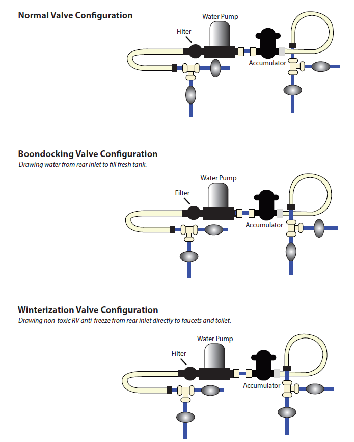

      Diagram for Elite II Plumbing - Valves Water Configuration Modes NORMAL MODE - This is used when connected to city water connection on the side of the camper or when using the water pump to pull from the fresh tank. Make sure the Fresh tank has water ...
