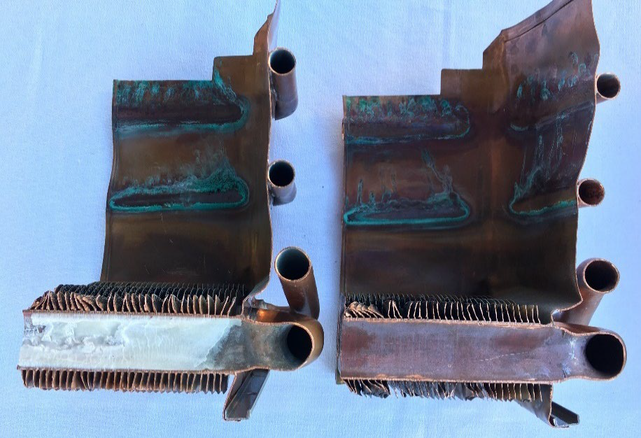

Typical Calcification Buildup VS After Decalcification with Truma Decalcification Tablets

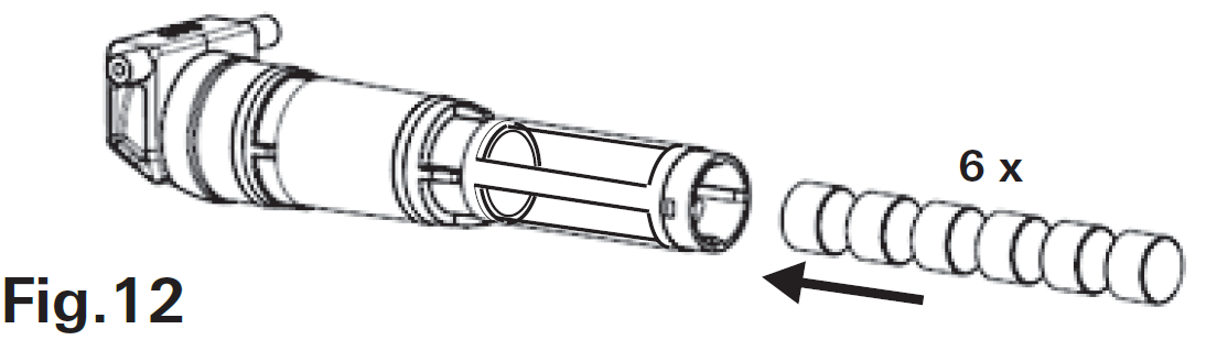

• Fill the water inlet filter with (6) Truma AquaGodecalcification tablets (content of one blister pack.)
• Re-insert the water inlet filter.
