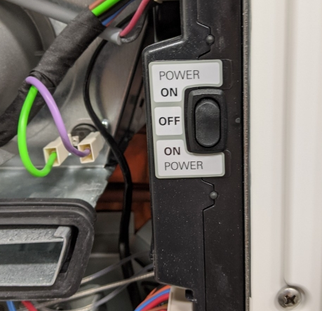

STEP 2: The outside switch on the AquaGo needs to be in the ON position, either up or down.

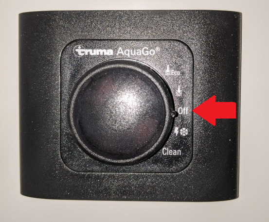

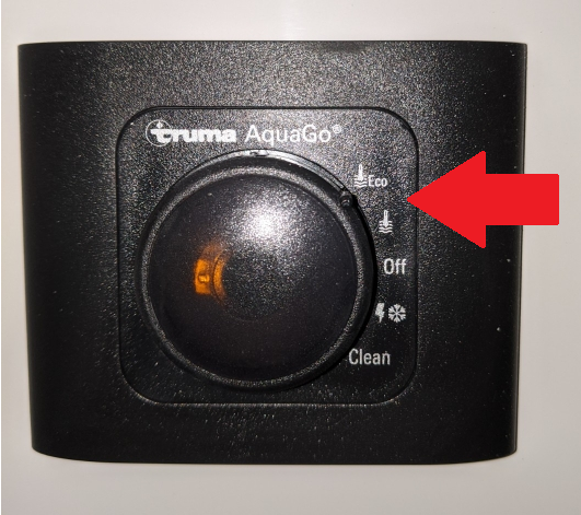

STEP 3: Turn inside AquaGo Control Panel from OFF to ECO or Comfort mode (top 2 positions on switch) until you see an Amber LED illuminate in the center of the rotary dial.

STEP 7: Turn the inside AquaGo Control Panel to the OFF position
STEP 8: Turn the outside switch on the AquaGo PCB to the OFF position and wait 30 seconds.
STEP 9: Turn the outside switch on the AquaGo PCB to the ON position – Green LED should illuminate.
STEP 10: Return the inside AquaGo Control Panel to desired operating mode until Amber LED
illuminates.
