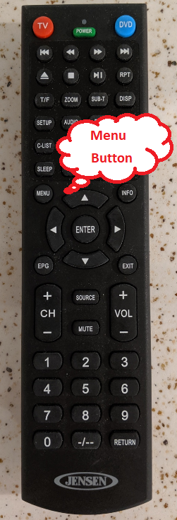

Step 2: Select the Menu Button on your TV Remote

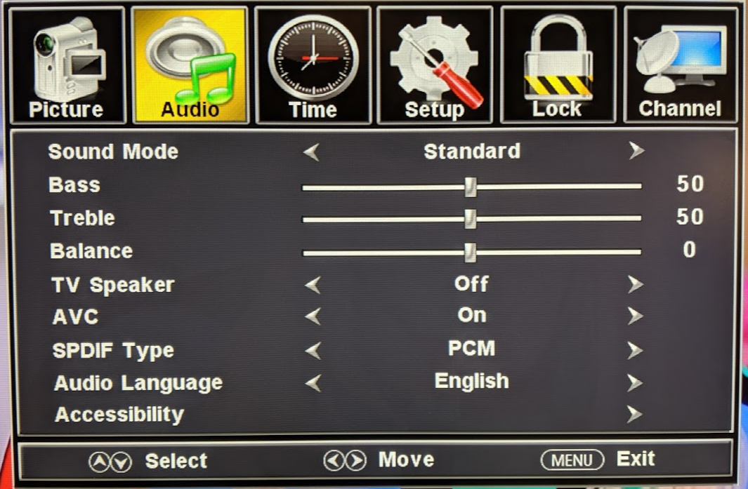

Step 3: Using the arrow keys move over and select Audio
Step 4: Using the arrow buttons scroll down and change turn the TV speakers OFF
Step 5: Select the Menu button again to get out of the Audio settings

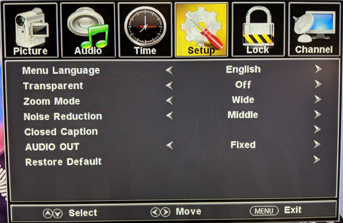

Step 6: Using the arrow buttons move over and select Setup
Step 7: Using the arrow buttons scroll down and change the AUDIO OUT to Fixed
Step 8: Using the Menu button on the TV remote, exit the Menu system
