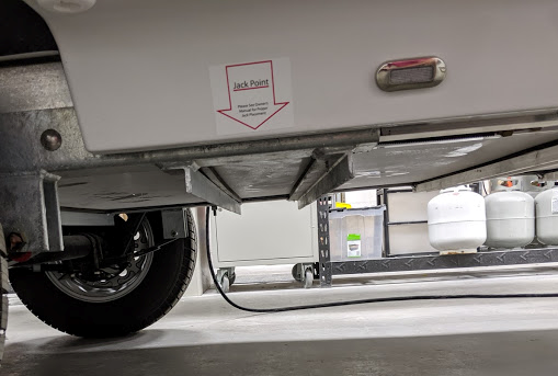

New model trailers (2017 & Newer) have an extended steel sub-frame assembly that provides ample room for a jack point either in front or behind the tire that needs to be changed. 2019 Models feature a convenient Jack Point sticker to help with proper jack location but 2017 & 2018 models have the same sub-assembly and jack points.
Curbside Front Jack Point
Curbside Rear Jack Location
Above you can see where the Steel Sub-Frame stops along the Aluminum rail

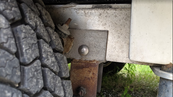

Older models (2016 & Prior) may not have enough room on the steel sub-frame to use a lifting jack(scissor jack or bottle jack). If this is the case you will simply locate the main frame rail point closest to the tire that needs to be lifted and use a lift pad that will help to distribute the weight.
Above shows older model sub-frame where it is just past the last hanger. Jack would need to be placed as close to the end of the sub-frame as possible.
