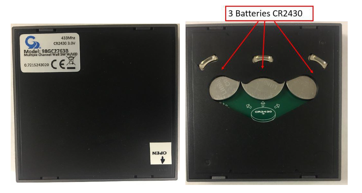

Changing the Batteries
To replace the batteries turn the wall switch over and using a small flat screw driver pull the cover off. The cover has the word "open" on the right bottom corner: See picture below
The wall switch requires (3) CR2430 3v Lithium batteries.
