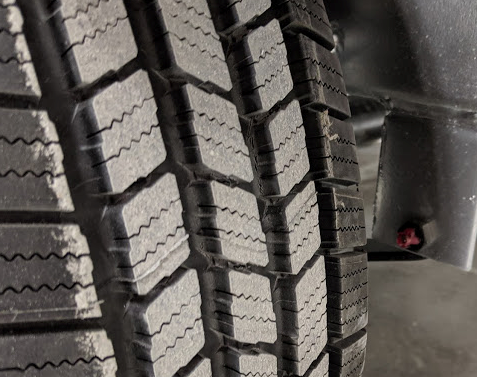

Above picture shows grease zerk forward of front tire

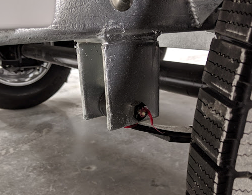

Above picture shows grease zerk behind rear tire

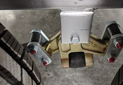

Above picture shows 4 grease zerks located between tires next to equalizer

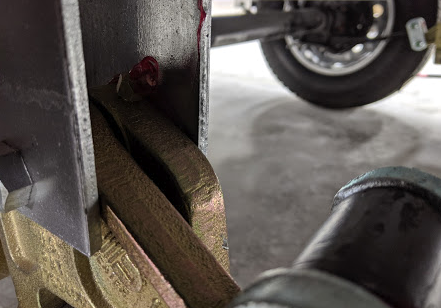

Above picture shows the forward grease zerk on top of equalizer
Above picture shows rear grease zerk on top of equalizer

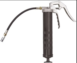

We recommend using a flexible hose on the grease gun to reach the 2 zerk fittings behind the center hanger on top of the equalizer.
