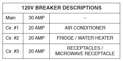

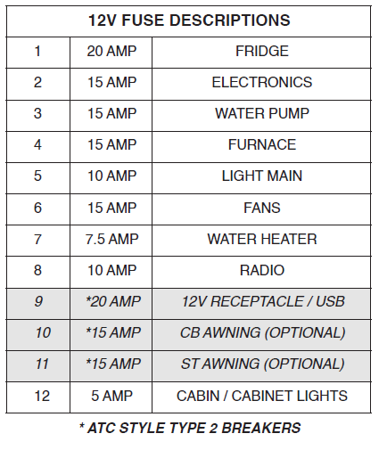

All component breakers & fuses for the 2020 models are located in the lower shell. Some components may have inline fuses and therefore are not located or labeled here inside the breaker/fuse box.
Standard models with charger built into converter box
Models with optional Inverter/Charger Package
