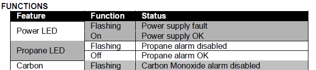

ALARM OPERATION
The alarm includes four LED indicators, an LP, CO and LPCO oscillating multi-tone audible alarms, and one Test/Reset button that provide interaction and feed back with your alarm. The indicators allow you to troubleshoot your alarm and to determine the proper actions to take. The visual indicators are labeled Power, Fault, Carbon Monoxide, and Propane.
The alarm operates in six separate modes that will be identified in this section.
Power Off Mode
This mode indicates that there is insufficient power provided to the alarm. The indicators and button will not function in this mode. Sufficient power must be provided to the alarm to exit this mode.
Normal Gas Detection Mode
This mode indicates that gas concentrations are continuously monitored. It also indicates that gas concentrations are at safe levels. In this mode the Power indicator will be lit, and all other indicators will not be active. The Test function for the Test/Reset button will be active.

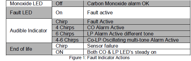

Fault Mode
This mode indicates that a fault has been detected that compromises some alarm function. If a fault is detected on only one of the sensors, the other sensor would function normally. The table below lists the indicator actions and the corresponding alarm status. This mode will be exited automatically when the fault is cleared.
If the fault persists, the alarm is not functioning properly and must be replaced to ensure your safety in the area.
End of Life Mode
The Detector will operate in end-of-life mode after the Detector has been powered for 7 years +/- 128 days. This represents the operating life of the sensors used to detect CO and LP gas.
After 7 years, the sensors are no longer reliable and the Detector must be replaced. Once end-of-life mode has been entered, it is permanent, even after a power out cycle. If the reset/test button is pressed during end-of-life mode, the audible alarm will be silenced for 48 hours before being automatically reactivated. The power visual indicator will be on and the CO and/or LP visual indicators will be flashing. The audible alarm will be sounding per table below.
